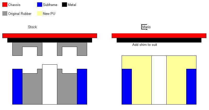

PostPosted: Fri Jul 10, 2009 12:59 am
It is there in the EPC but it's not obvious
If you look HERE where I stripped the rear subframe there's some shots of the main mounting points with
and without
the washers
part number is
52272-20030 STOPPER, REAR SUSPENSION MEMBER, UPPER
Unfortunately I don't have a picture of the underside to show. It has a stup in the centre which slides over the metal insert in the centre of the standard subframe bushing, then a gap then a ring of rubber which contacts the circular part of the subframe itself
To be honest I doubt if it matters if you remove that washer and use Marios bushings directly against the chassis. The difference will not be very large and you'll only lower the rear (the correct way without buggering roll centres) by 5 or 6 mm

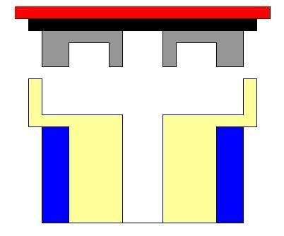

Here's a quick artists impression of what I think you have
I guess you might have to get some spacers made up to suit
But it might do this
Difficult to tell without seeing pictures of the top of it!
Yes sure, but only difference is that the rubber OVER the subframe has not the same thickness (as it appears on your draw) of the nylon spacer...

PostPosted: Fri Jul 10, 2009 10:55 am
To me the rubber looks the same size as the bushing
The rubber has a metal backing plate attached though (this is what presses against the chassis) and I think it's this that makes the difference in the thickness

PostPosted: Fri Jul 10, 2009 11:15 am
it may not be obvious but the rubber is stuck on to a circular metal backing plate. You van just see it in the photo and it should be clear in the diagrams
I think you'll need to make up a metal spacer to replicate that so that Marios bush + spacer is the same thickness as the stock rubber bush on its backplate
Yes, I think this too...
