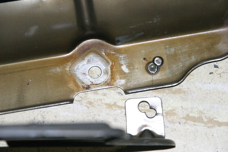

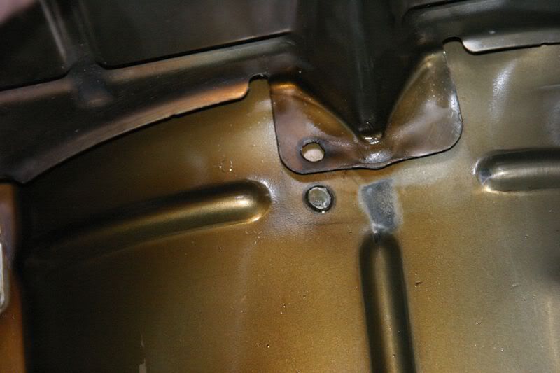

However, I need the sump for the ST215 engine so today I removed it to be greeted by this. Of all the things that could be causing a bottom end rattle I never ever even considered this :shock:
It's possible that this lead to the demise of the engine as the baffling in the sump is obviously not right. When the baffle detached it dropped to the bottom of the lower pan and might have cut off/hindered oil flow into the lower section where the oil pickup is
Throw in some track action and maybe surge/starvation ensues. I can already see that for sure #2 big end is shot and #3 is not far behind :(

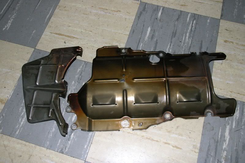

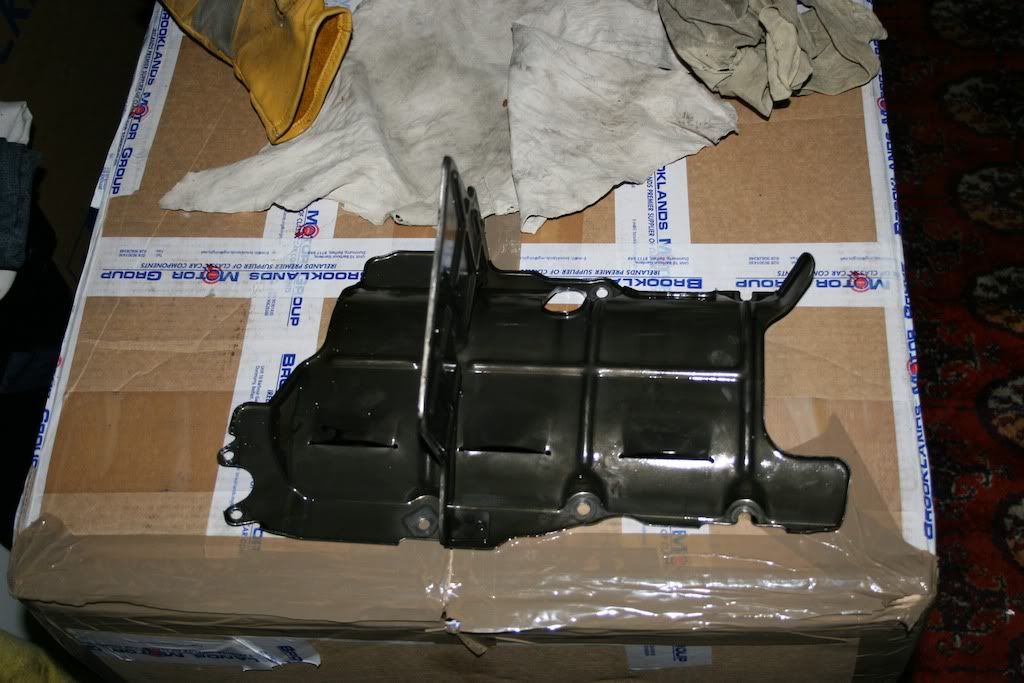

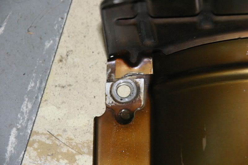

Compare this with the scraper/baffle plate from the Caldina. It should be one piece
The mounting tag one side has cracked. The other two connection points have failed spot welds allowing complete separation of the baffle
This is what it should look like

The pics appear to show that the ST205 scraper plate is a two piece affair albeit sport welded together whereas the ST215 scraper is a single piece part?
Seems strange that this should have failed. Presumably its some sort of fatigue failure due to vibration?
PostPosted: Wed Mar 17, 2010 12:32 am
The two scraper plates are pretty much the same design. TBH it looks a bit rubbish. It's flimsy when you look at it knowing that there's been a failure
However, it's an extremely uncommon failure - I've not seen another in my years of four ownership.
It might be worth Jon adding a couple of additional tabs to yours given that it's likely to see lots of high RPM ;)

Out of interests, I actually gave this a good examination today as I fitted the correct sump. The Caldina version is the same but mine looks fine. I think it's a 1 off failure in the 205 but I'd still look to beef up one fitted to a high spec engine
