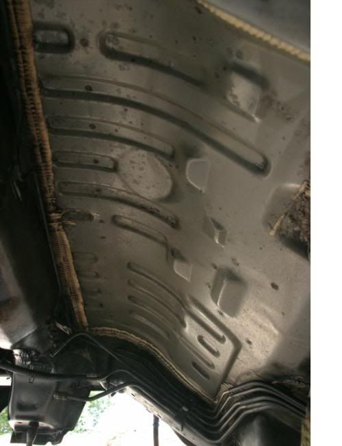

Steve, isn't that last picture upside down m8.....unless you've got the Black Knight on a rotisserie :lol:
What are you using to kill the small spots of rust bug before you spray the black?
PostPosted: Sun Sep 28, 2008 10:32 pm
Sadly the car is very much fixed in position. The two remaining attached wheels are firmly planted on the drive meaning that the painter has to adopt the rotisserie approach. This is not fun in any way shape or form :(
The process I used on that section:-
Thorough degrease/clean using brake cleaner. I find this most effecive at cutting through the road tar, diff oil deposits (from diff breather) old soft underseal and general gooey crud that accumulates
Then everything gets attacked with the wire brush to remove flaking stuff
Then remove bad rust flakes with a chipping hammer type thing (I use a paint scraper in actual fact)
Then sand back the worst of the rusr spots with a bit of 80 grit
Then apply rust conversion solution to the rust - I use an old bottle of Trustan which has proved itself on the keels of our boat. But it ran out today so I expect to use kurust next
Sand back this rust converter paint and re-apply
Zinc/acid etch primer coat
A good coat of Tetrosyl stone chip
In that area that I photod I'll probably leave it at that. I've barely removed any of the original paint and it's in an impact free zone
For the "main" underbody I'll probably go rust converter, prime, regular 2k paint, stonechip, paint
It's a sub optimal solution but given the constraints of doing it on stands on the driveway it's about the best I could come up with

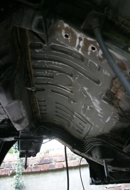

After a good clean up. First with engine degreaser, then brake cleaner. Doesn't look too bad in the main floor section but close inspection shows a few micro-blisters. Still, it's very tempting to just bung more underseal on and walk away
However, just to disprove all of you who think that's what I did lol
Sadly the poop Whiteline ARB brackets have transferred their rust into surface rust on the chassis rails. It's not serious luckily. Shown here before the first application of rust converter

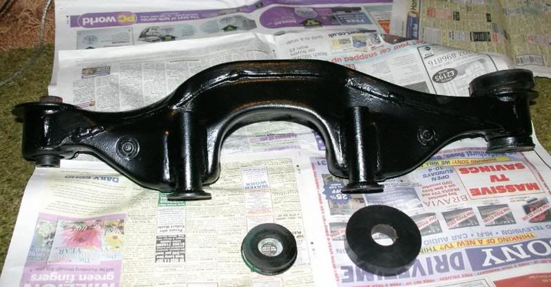

Hiya Nigel
I have a suspicion that we're talking about diferent bushes here
The ones in distress on mine are/were the small diff carrying subframe to main subframe ones
Sadly the main ones are an integral part of the small subframe which Toyota want £250 for
My solution was to replace them with Powerflex 200 series washers.
I used 2 in total. A 75mmx32mm (GPR part PF99-206) and a 50mmx17mm (GPR part PF99-204).
Both were then cut in half to give 4 washers in total. 2 @75mmdia, 17mmish thick and 2@ 50mmdia 8mmish thick
I chopped the "castellated" rubber bush off the top of the beam. and then dremmeled the centre of the 75mm washer to suit the remaining tube stub. then I dremmeled the centre of the 50mm washers to suit the lower mounting
Hopefully you'll get the idea from this. You can see the new bushes and their assembled position on the right :D
