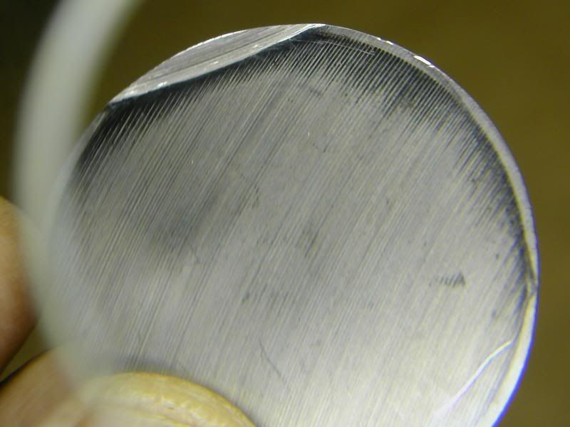

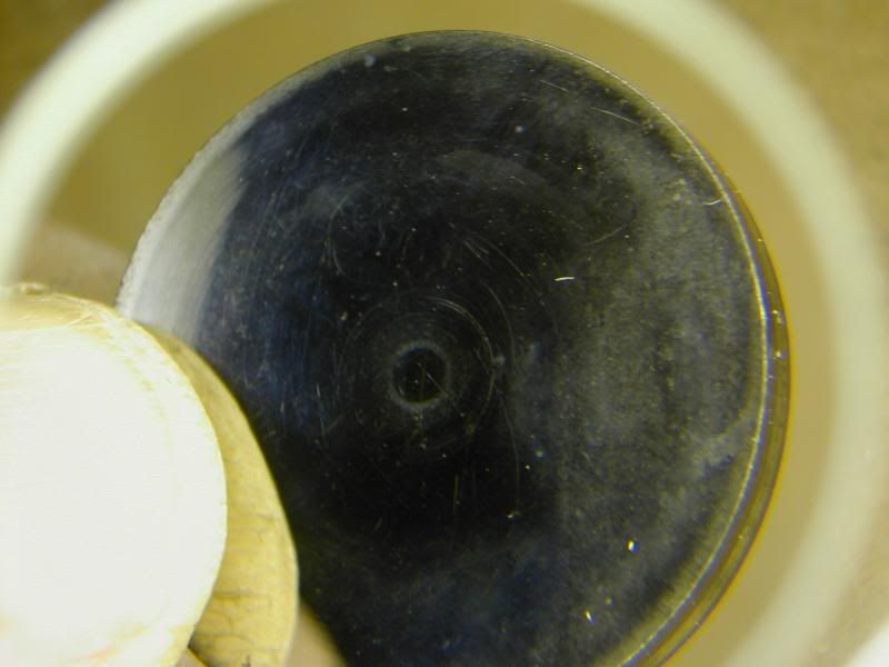

Found this on a cylinderhead seems not the usual Toyota finish for a valve bucket shim. :lol: guess what it came out causing other problems.

:shock: Ummm! Not good.
I would hazard a guess that this happened to an ST185 CS with a forged engine.
The cause being a sticking valve spring.

another product of "yee-ha engine works" then.
How much are shims? Is it really worth trying to grind one down? I am sure it coudl be done and finished so as to not cause any issues - but erghh that is shocking.

My guess in a previous post is pure speculation. :?
(Perhaps datajon can enlighten us).
It's based on a known problem with 400+ bhp ST185's and shims literally flicking out of their seats. That's why it's advised to go for the shimless bucket conversion.
It's not unusual to find shims that have been skimmed to size in race prepared engines - I have heard that it is common practice.
However, the finish on that one is shocking. :shock:
I wouldn't have thought that the shim itself caused a problem - more like compounded to a problem.

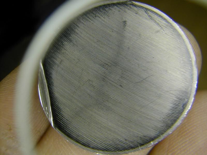

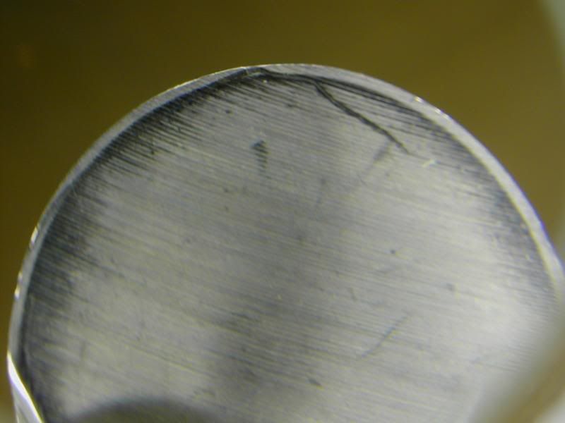

shim cam out due to rough surface, poor adhesion due to the *bleep* surface thats what went on..
the spring failed from impact from the shim jamming between bucket and camshaft lob..
even found the impact spot on piston...nothing gets pass me..
SPRING DID NOT FAIL CAUSING THE PROBLEM FACT. , its clear as day what went on.
muddy water you have no idea, you don't understand whats gone on.
the ra for a cam shim should be low, that surface finish is over 300 please don't tell me to suck eggs when you know jack about what it should be.

the fact is they ground the shim down to the size, the fact is it caused the problem, the fact is i have all the broken parts, the fact is i fully understand how to work things out like this , fact is i even get paid for this sort of stuff, fact is you know jack and you should wise up, its not speculation its hard facts, so be careful who you use when it comes to this sort of work.

I measured a few springs from the cylinderhead.
static height 44.25mm
at 34.25mm = 22.0 - 22.5 kg = stock spring based on two samples.

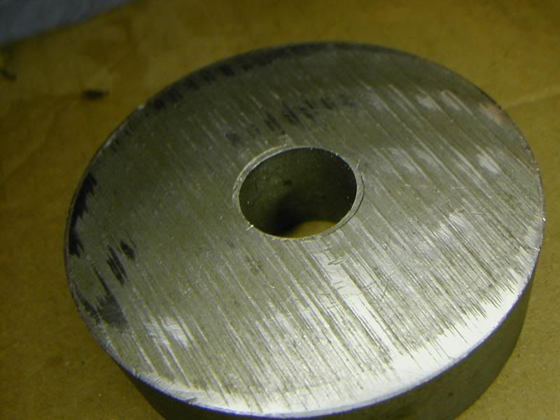

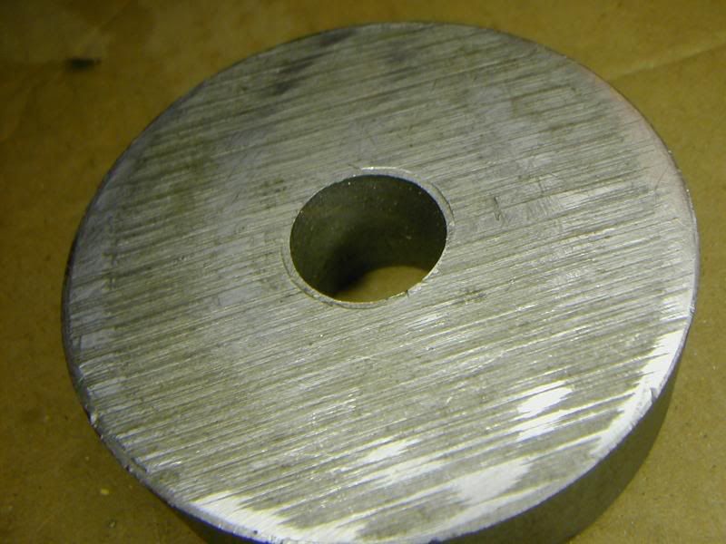

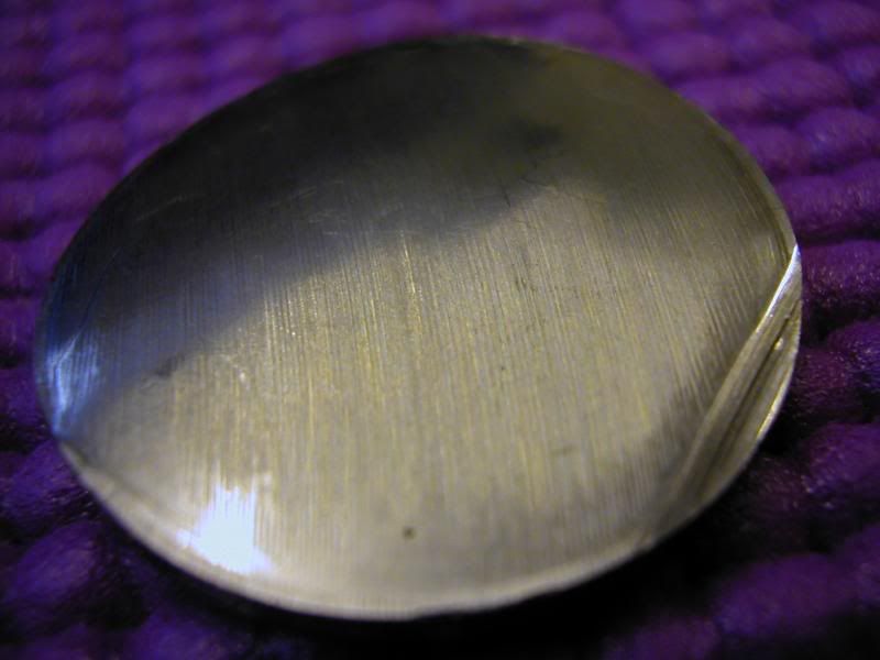

few more images
stock 140,000 miles of service

Must admit get a similar finish using the bandsaw cutting 3.25" steel bar.. :wink:

I've got a nice barsteward file at home Jon if you wan't to go for a better finish next time :lol:

Thanks for posting the pics DJ,
Its especially interesting to see the 140k mile stock shim!

Mind you, if I'd come across this I wouldn't be very happy either, especially as shims aren't that expensive.
Please excuse my ignorance, :oops: but ...
Do I read this as static height 44.25mm and 34.25mm with a 22/22.5 kg load? :?
Do I assume that you found stock springs in the head?

just an update.
found more problems with this said head that was installed by the said person.
all the buckets are worn, some shims have worn badly..
rest of the cylinder head is okay, just buckets & shims that are not okay.
