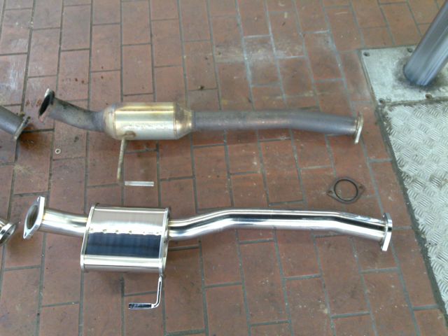

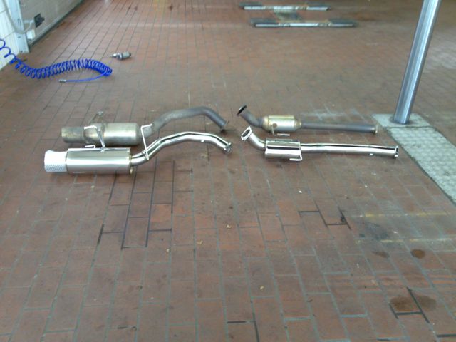

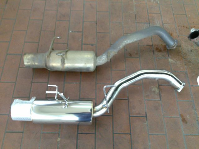

Here some pictures of my old exaust system, a Blitz NürSpec R next to my current one, a HKS silent hiPower which replaced the Blitz:
To explain the resonator box: There are two versions of the HKS hiPower available. One is the "hiPower" without resonator box, but there is also a more gentle version called "silent hiPower" with resonator box.
