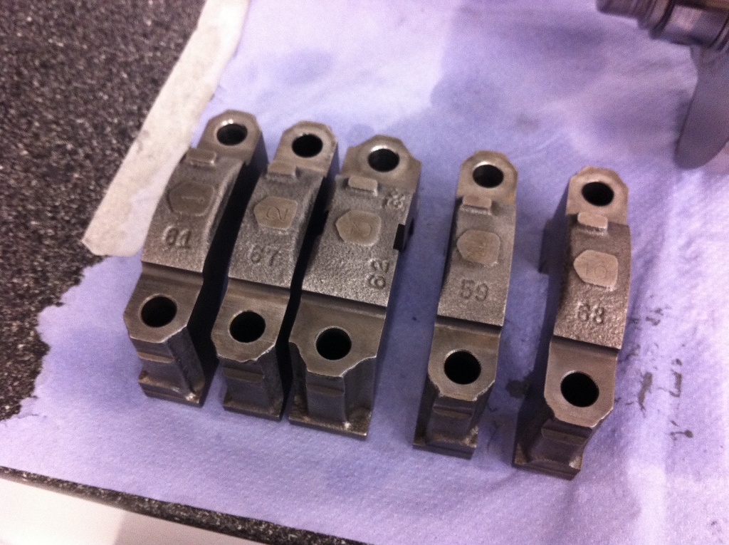

As per Kris although I would also add, take lots of photos before and after. I know you have taken some but you can never take too many, especially of part number/size stampings etc. Given that Jon will be doing his own measuring I'm sure this will help guide him and maybe even save you some money by avoiding blind alleys. Just a thought.

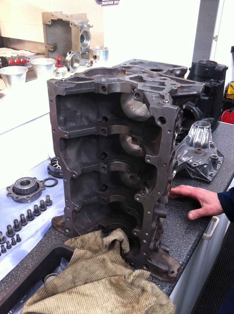

The engine was dropped off at the builders 3-4 weeks ago and the process of measuring up was started. The block was also ultrasonically tested.
There were 3 main findings:
1. The bores have slight ovality that will require going out to 86.25mm Pistons.

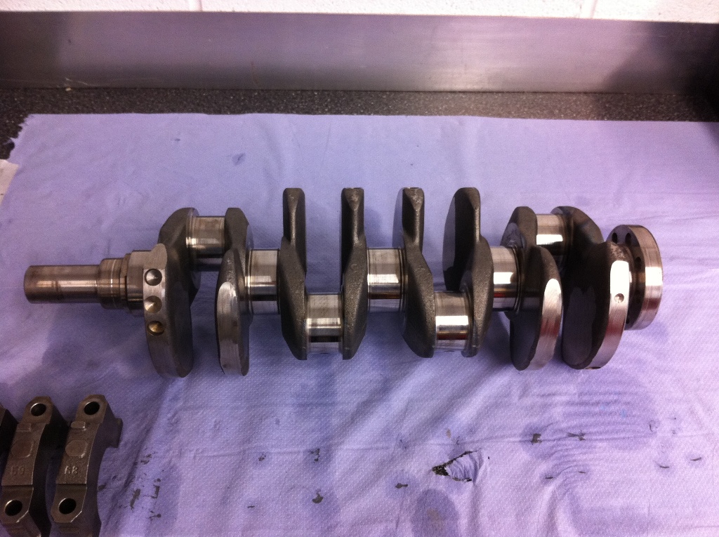

2. The crank is slightly bent 3 thou, this will be straigtened and the surfaces measured then polished or ground and polished to remove the wear marks.
3. The ultrasonic testing revealled that the block is a good one and does not have an especially thin wall between 2/3.

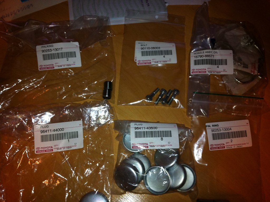

New parts from Toyota - core plugs, dowels and new oil squirters.
The engine, crank and bearing caps have also now been acid stripped and have come up nice and shiny!

Thanks for the pics and part numbers, might come in handy later on. :)

The crank has also been straightened and polished.
