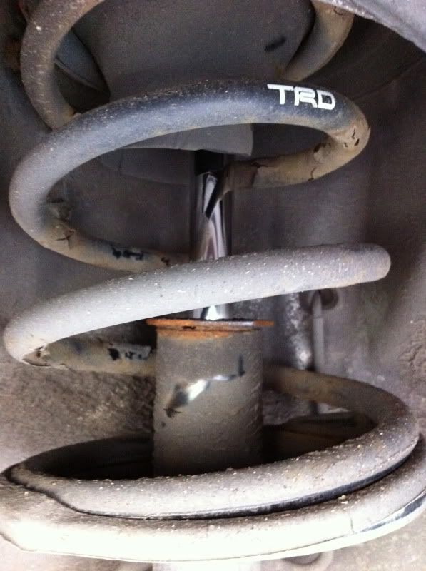

Hi guys. Routinely swapping tires front to rear yesterday and planning on changing the tired wheel studs on the front while the rims were off but found stuff that could explain my lackluster steering/handling.
This is the suspect shock - moisture/greasiness around the lower section - OSF

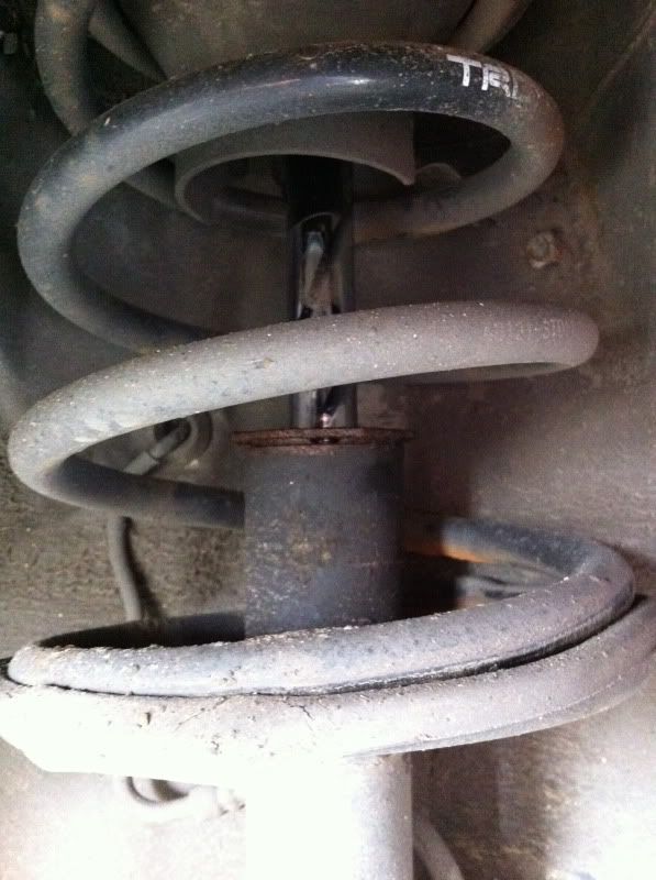

NSF, less muck and moisture

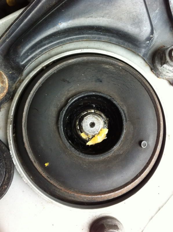

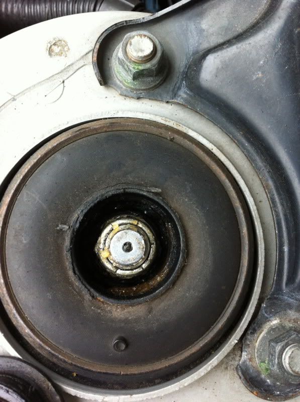

Also noticed but not visable in the first picture is a dent in the lower shock reservoir which can't be healthy, both upper all joints appear to be torn too.

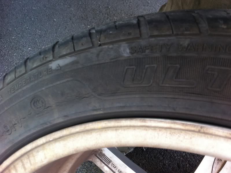

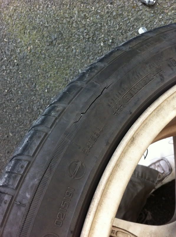

Inspecting tyres too and found that the older ones still with 4mm even'ish tread are starting to crack, also not good.
What do you guys think to this OSF shock, past it's use by date or worth re-application of a new upper ball joint? Handling is pretty crappy and wallowy if I'm honest and feels like it's 'searching' in a straight line and the front washes out under fairly normal cornering. Just doesn't feel like it did 4 years ago and I'm assuming that even with the TRD lowering springs it shouldn't bottom out too easily? Because it can, and feels slow to re-damp.

If you 'bounce' the front of the car that may give you an indication of the state of the shocks. If the shocks are worn badly then the car will bounce up more easily than if the shocks were doing their stuff. If you have a set of spring compressors you could check the state of the shocks with the front end of the car jacked up until the suspension is on full droop and then unbolt the top of the struts from the turrets. Compressing the springs should then allow you to check if the damper piston can be pushed in and out easily by hand. If this is the case then shocks are knackered.
Your perished tyres certainly won't help your handling either and then theres the safety aspect to consider as well. It wouldn't do much for my peace of mind if it was my car!

Leaking shock absorber is an MOT fail so even if the handling was spot on you,d need to resolve that
With a car that feels wobbly to drive replacement of both shocks is a no brainer. Note that the new shocks (you will have to change both fronts as a pair) will not come with upper ball joints - these are desperate items

Thanks guys, yes I've been looking for a reason to get rid of those tyres as the grip is appalling compared to the new Falken 452's. I'll either get some more Falkens or some Eagle Asymmetrics. Researching the KYB excel G struts they seem to be 25% extra damping over standard and include new upper ball joints thankfully and come in at roughly £107 each plus delivery from http://www.buypartsby.co.uk/details/TOY ... -absorber/

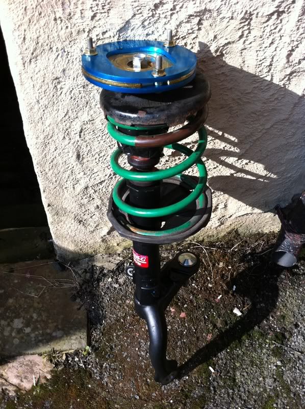

My front shocks were in similar nick, and i've just replaced them with KYB (ball-joint incl.), whilst adding Tein lowering springs and new TRD top-mounts.
I got the shocks on ebay for £200 all in, from this seller...
http://myworld.ebay.co.uk/miss-alia/&_t ... 1439.l2754
Big improvement, but it only serves to highlight the pressing need for new front tyres and the looming fig. 8 change.

In two minds about replacing my top mounts too, they don't seem to be cracked as such but they are bulging.
