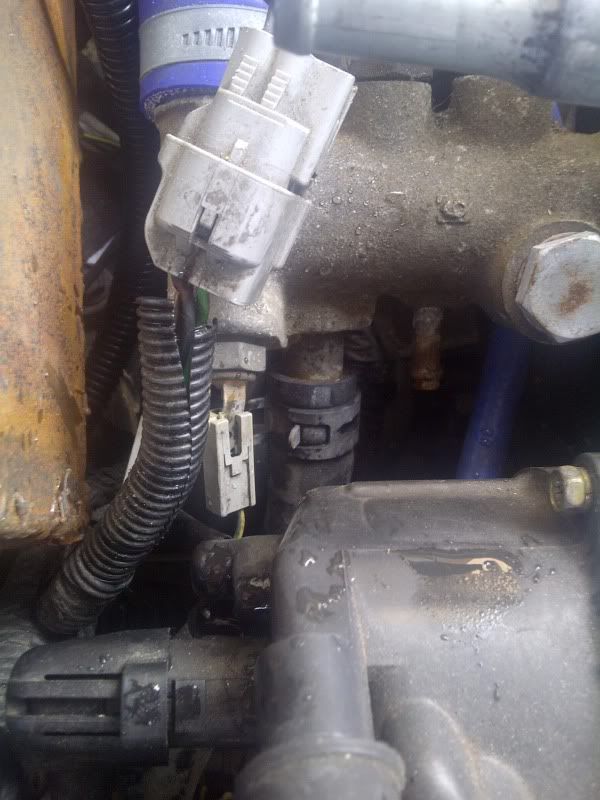

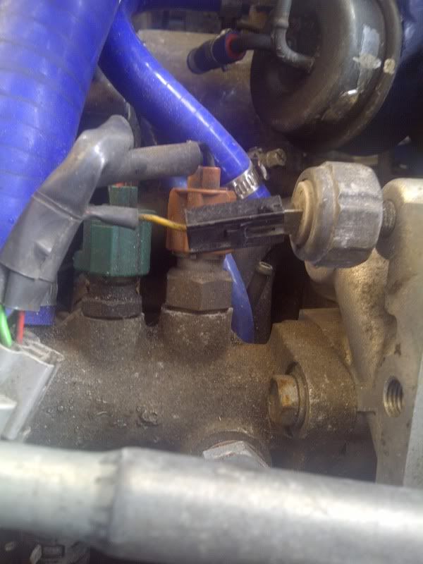

hi finally got my car started ( read over fuelling ) however now it starts its very lumpy revs to 3000 revs then sometimes will rev more but very lumpy plus also get a little white smoke the car has been stood a while and recent weather has ment it has been cold will be taking it to a garage next week if i carnt sort out the problem but to save a few quid any ideas

Maybe worth checking all the simple stuff first such as Ignition and Fuelling. Could be dodgy ignition if it has been sitting for a while but Ive got a bad feeling that it may be worth doing a compression test. Whats your water levels like, are they remaining steady? I had a similar problem with my MR2 turbo and it was head gasket.
Im sure yours will be something simple and not scary but head gasket is a possibility
PostPosted: Mon Jun 04, 2012 4:14 pm
Possibly the cold start injector is stuck open or the wiring isn't connected right.
I suspect the latter.
It's a bit long winded but you could try un plugging the cold start injector but this will mean stripping off the topmount then possibly the throttlebody as the injector is behind that and I don't think you can get to the connector

thanks all the head gasket was done 8 months ago so better not be gone lol will be checking the the other parts tomorrow

Sketch did you sort out your connector issue?

belived to connect on the back elbow behind water temp sensor but the connection has broke new 1 orderd now just trying to sort out why it wont rev but have been told to double check me ht leads and as it had super unleaded in it that could be part of the problem running to rich normal fuel put in but lumpy didnt mix to well lol
