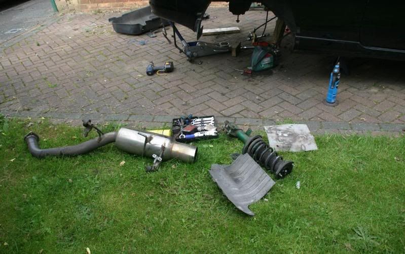

For a little while I've had a bit of an odd grindy noise coming from the rear of the car
After a close visual inspection I think I've found the problem
Hmm, something seems to be missing
Maybe it's a trick of the light or something

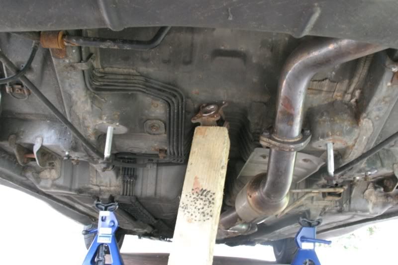

Better have a better look underneath then
Nope, definitely something wrong there. I think the bit of wood has been catching on the road causing the grinding. Mystery solved

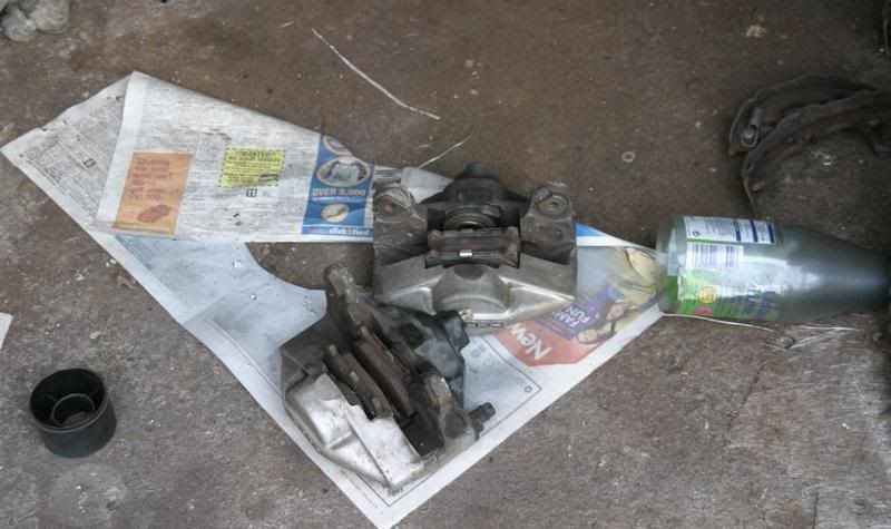

Although, what's this :?:
Maybe it's the real cause of the noises. NS rear handbrake pad is down to metal. Not sure what happened there. Looks like some muppet probably fitted the shoes incorrectly although they seemed fine :oops:
Off to Mr T for a probing for new handbrake shoes then :(

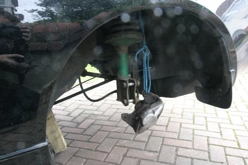

Further investigation has revealed a rather tired diff which was te main reason for dropping the frame - along with a lick of paint
The diff has 3-4mm of in/out travel on the offside drive flange. I imagine the packer has disintegrated which probably also explains the afro on the drain plug :(
Further investigations to follow

I like afros - can we have some pics?
Looks a bit nasty under there, I assume this is the UK car? - maybe need to add the rear ARB brackets to teh parts list?
PostPosted: Mon Aug 18, 2008 11:46 pm
It's clean as a whistle apart from the whiteline brackets considering it's 12 years old :lol:
Very slight surface dust. An application of waxoil is all it needs
PostPosted: Tue Aug 19, 2008 12:32 am
Didn't realise you were going to drop the subframe as well :shock: I've also found the Whiteline kit is prone to rust even altho I took the precaution of painting the brackets before fitting them. If you have a Whiteline ARB why is it black? All of mine have been silver :?
Would agree that the impression of rust underneath is worse than it actually is. My 14 year old UK car looked very similar but got a clean bill of health from JEMS saying they were very pleased with the overall condition of the shell

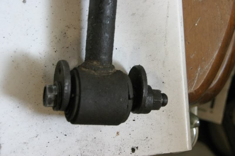

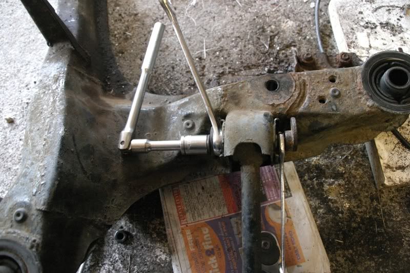

First job was removable of the "adjustable" rear arms. These have never actually been adjustable on my car :( :(
The adjustment is done with a snail cam bush like this
Which fits in the inboard end of the rear arm like so
Both cams are locked together by the central tube which slides through the arm. When you turn the nut end of the tube the idea is that bots cams rotate pushing the arms away from the frame.
Well, on mine these cam tubes had well and truly seized into the bushes. It took me a couple or three hours per side before I was able to remove the adjusters and release the arms :mad:
A very very very Heath Robinson bearing puller was used to do this :oops:
The subframe is now ready for prep and paint. I'm awaiting a quote from my local media blaster - otherwise it will have a date with the wire cup and Grinderella :twisted:

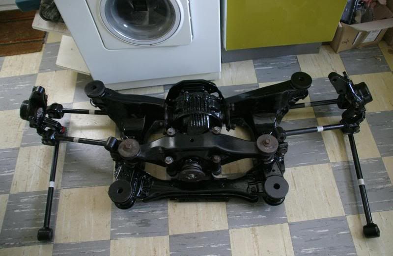

So, state of play last Friday
Time for a first mockup build to identify missing parts over and above what I already knew
Nothing obvious jumped out at me :D
PostPosted: Sat Sep 27, 2008 4:52 pm
And to bring it up to date
Finally with the rear subframe ready to go some re-assembley can begin. Cue well oiled machinery, clued up operators with the patience of a saint etc etc

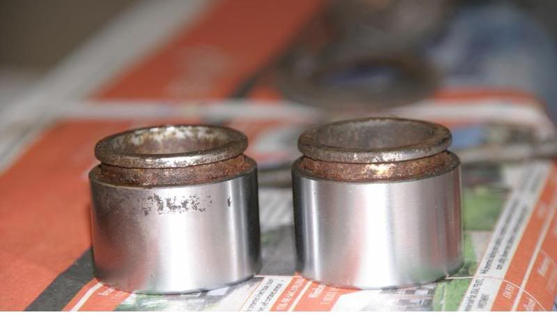

Er, these came off in me 'and. I barely touched 'em.
And I was just trying to put them somewhere safe when these bits fell out :(
Ah well, new pistons are only 12 snots ea and a rear seal kit comes in at 25.

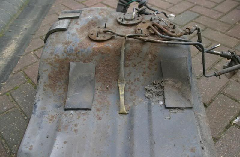

Would you Adam and Eve it. This blimmin thing fell off too. Not sure where it came from :?: Although it does seem to be full to the brim with petrol :roll: :oops:
Could have sworn I parked it up empty.
That's going to need a new fuel pump bracket methinks. Mr T tells me it'll be here on Wednesday
