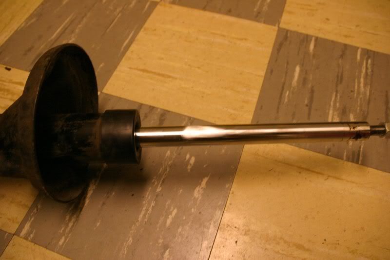

Well, the damper suspicion was correct
The shaft is visibly worn and the top bushing has distinct play
