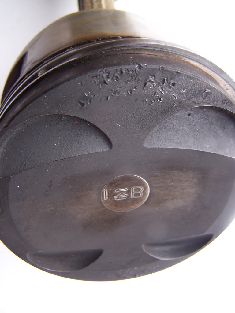

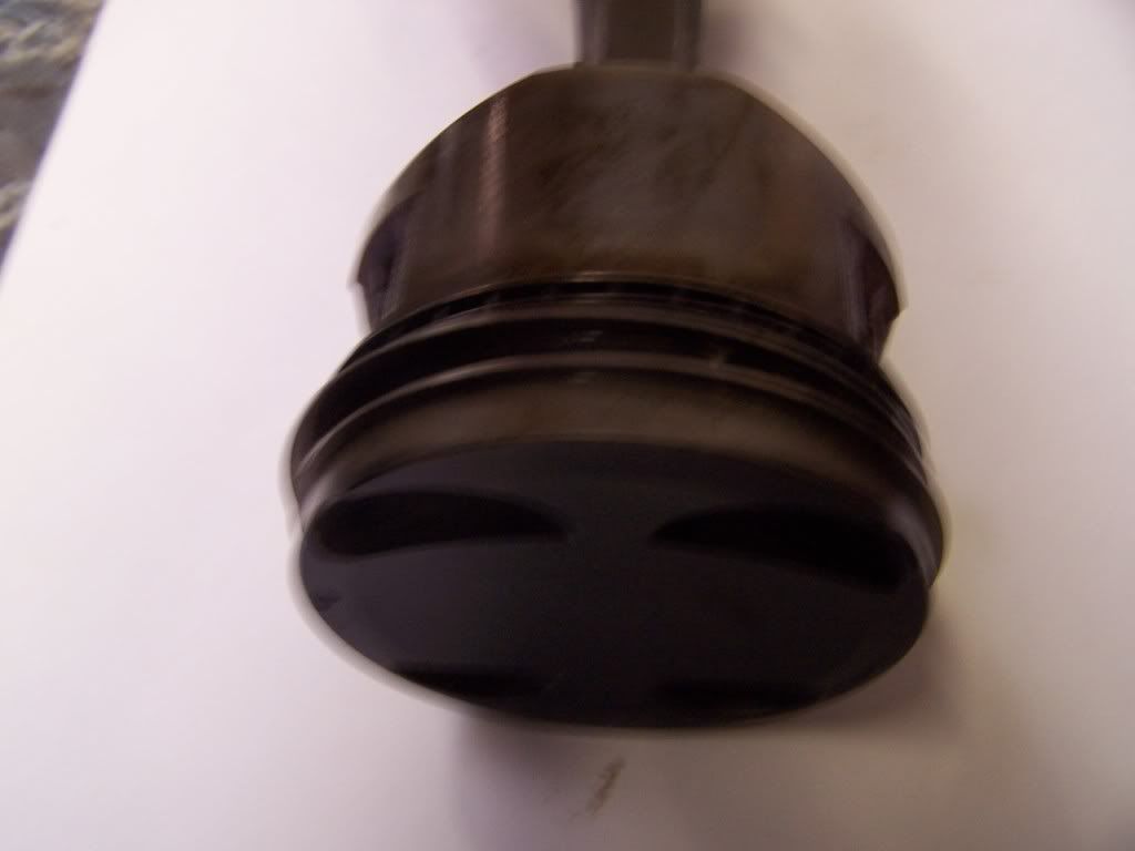

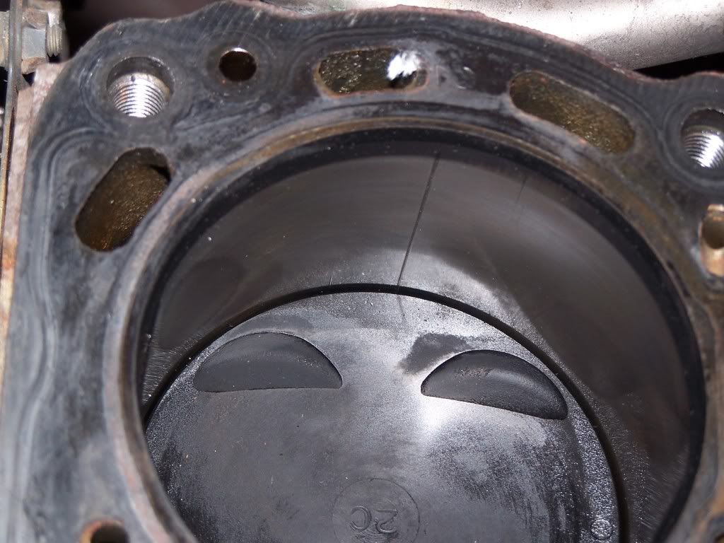

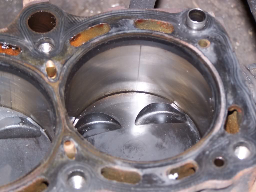

Started stripping the engine, and wasn't surprised to see a couple of scores in No.4, however the piston & rings appear OK apart from the corresponding score marks.
I'm guessing the scores are the result of foreign matter lodging between piston & bore and staying put for quite a while - they are quite deep.

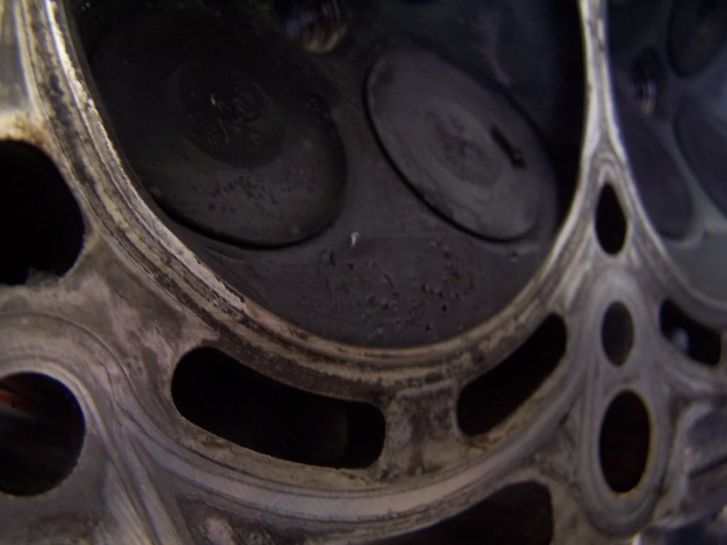

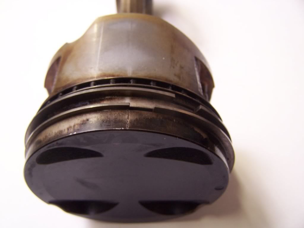

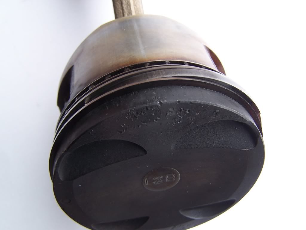

Stranger was that No. 3 had the failed ringland. There are indentations on the top of the piston and in the head. There is build up of material on the edges of the indentations so I'm thinking this is the result of foreign matter rather than detonation. Seems likely that this caused the ringland failure.
I'm now suspecting the misfire and ringland failure are probably not related, but what would cause the misfire ? Next thing will be to strip that end of the head and check for broken valve springs, cracked valves etc.

In my experience ringland failure in the 3S-GTE can manifest itself in many different ways. I've known some minor ringland failure where the engine has continued to function for some time and also the other extreme where the engine has failed spectacularly.
In my own case the engine pressurized the crankcase forcing oil up the breather, through the turbo compressor and into the charge cooler. Not a pretty sight :( This was accompanied by a loud knocking noise and oil smoke from the exhaust.
I havent yet had the head off to see what actually broke but I expect it to look pretty serious.
