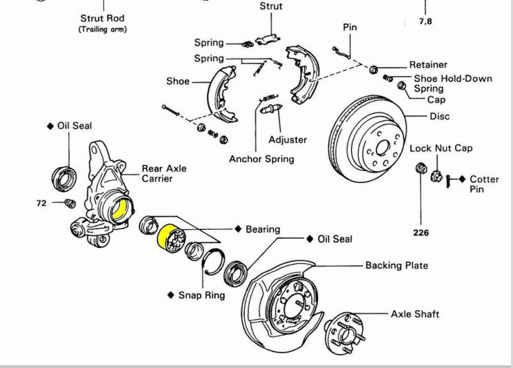

Been looking at your write up and took the exploded diagram off it too so I could get my head around it. It simply sounds to me like the outer surface of the bearing has gotten itself stuck in the axel carrier and it's non removable as a result. Does that make sense?
They said it was a mess inside, rusted and corroded.
These are the parts I think are stuck together... albeit front not rear axle
The message from the mechanic reads, "it's the outer shell which is stuck to the hub itself. This one seems to be an abs hub with the sensor removed."
I've got a feeling I'm completely wrong here...

The outer bearing housing needs to be pressed out of the hub...
This picture doesn't show how I did it but it does show the old knackered bearing still retained within the hub.
I think I just used a suitably sized socket to press the bearing out from the hub... It is pressed out from the inside of the hub to the outside as shown in the picture you just posted (if that makes sense!)
The worst part of the job is removing the inner race bearing surface from the stub axle... you need to grind away enough of the material to be able to remove this from the stub axle
By the fourth bearing change I got a lot better at it, lol!
I'd also recommend reading the how to remove 165 wheel bearing as this has additional pictures and probably shows this better than the 205 write up I did...

Thanks for taking the time to do this, Kris. By the sounds of it then, it is the outer bearing case that is stuck in the carrier (the part that you used 4 tons to push out in the 165?). That's all i can deduce from "it's the outer shell which is stuck to the hub itself." No surprising then he described it as having completely disintegrated inside.
