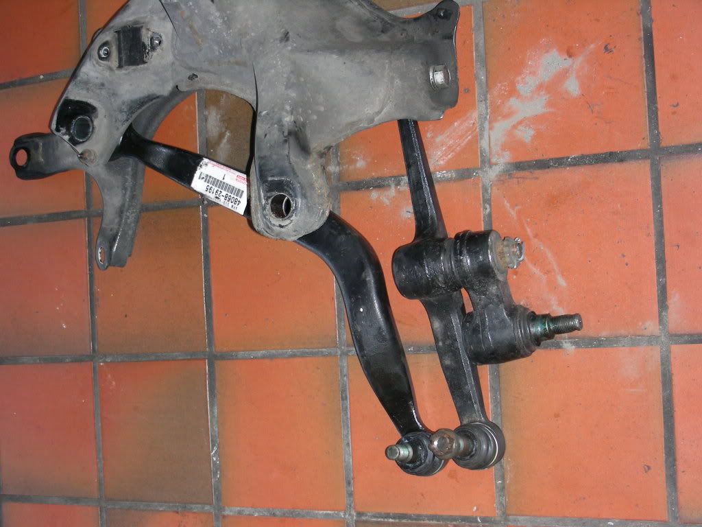

"Nigel, I have many spare banana arms if you get to the stage of damaging or destroying the ones on your car you are welcome to a couple".
Cheers Don That's very kind I'd be more than pleased to take you up on the offer I cant see any way either can be saved now. But would the banana arm rubber bushes (link end) need changing? Or perhaps more importantly can they.... without buying the complete section?

I'd go ahead and order the 'mushroom' mounts from TCB if that's what they call the crush tubes. You'll need them anyway if you remove the banana arms.
I'll need to dig out what I have and check their condition. The first opportunity I'll have to do that is next Sunday so I'll report back then. Watch this space!

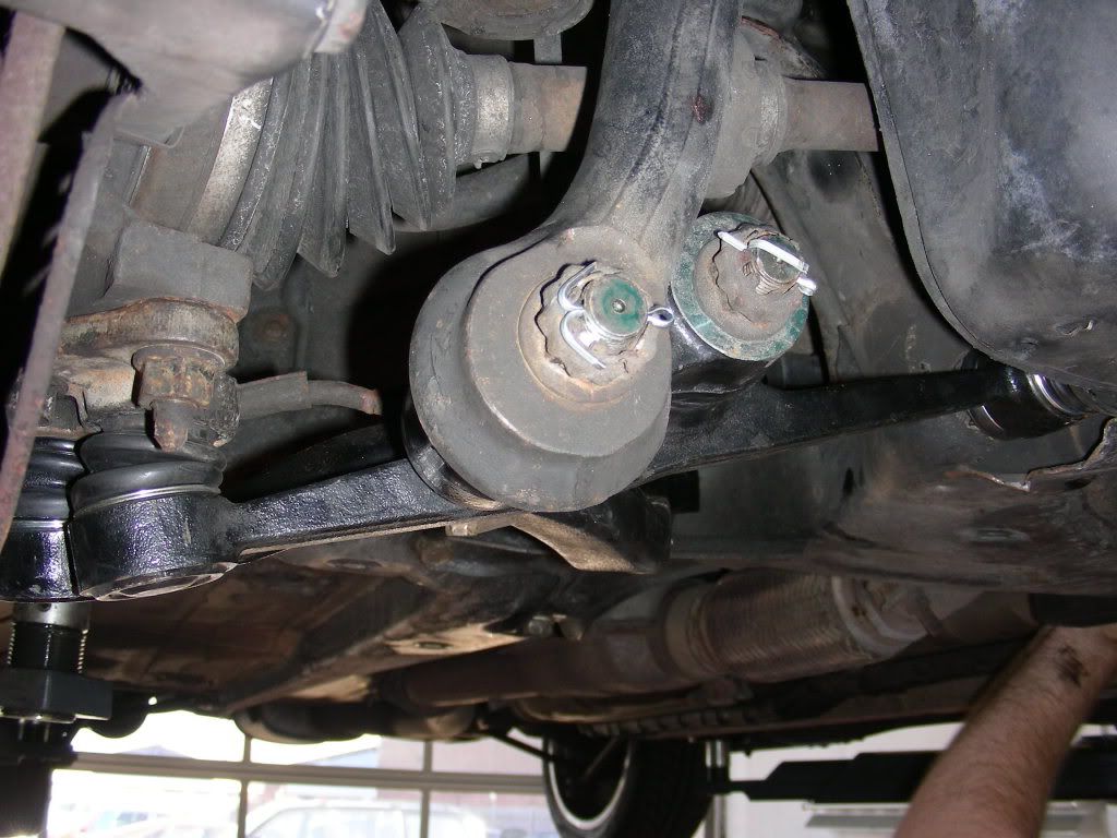

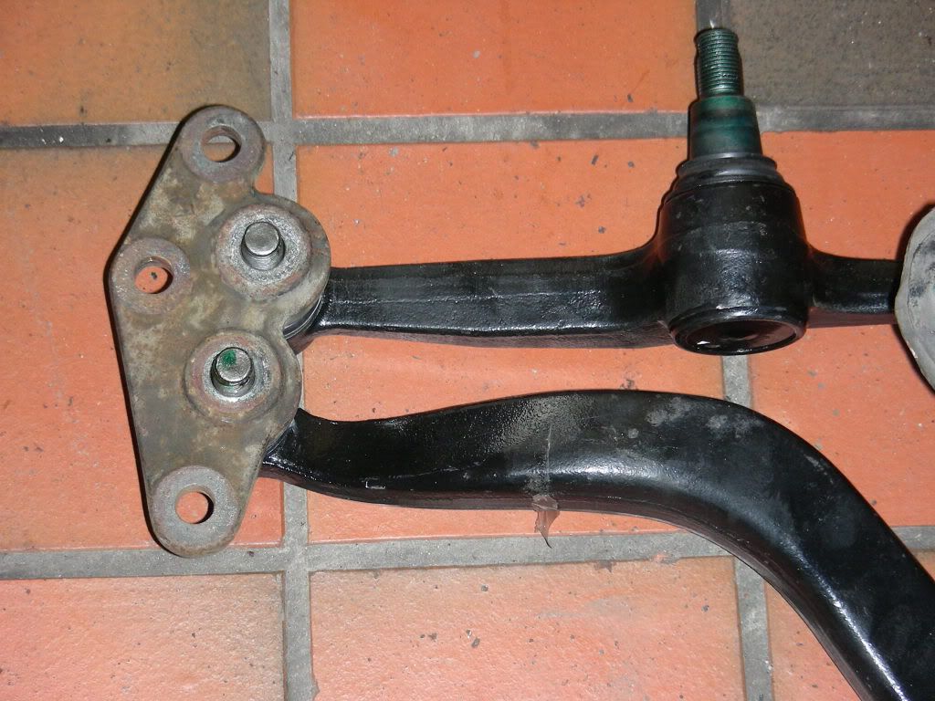

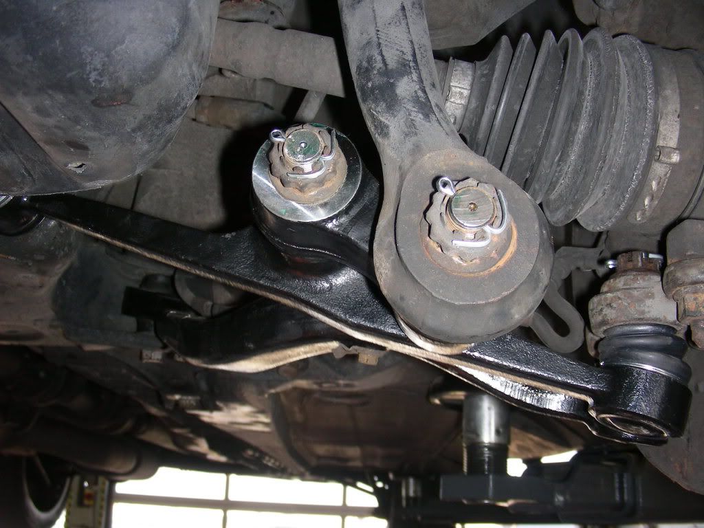

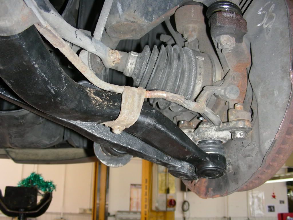

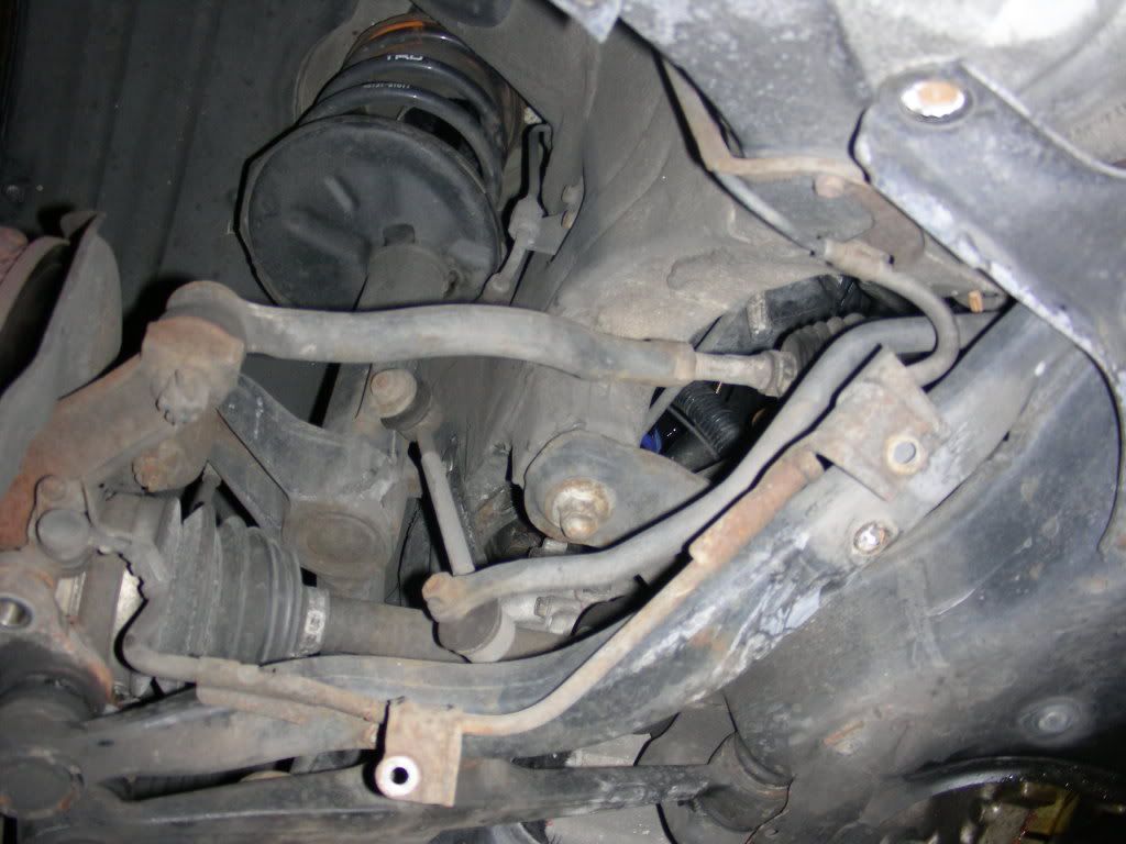

Hi folks, Just to update following sterling effort by Mr P Staurday am "Batmobile" is now all figure-eighted-out again and takes to bumps and curves again like a duck to water.

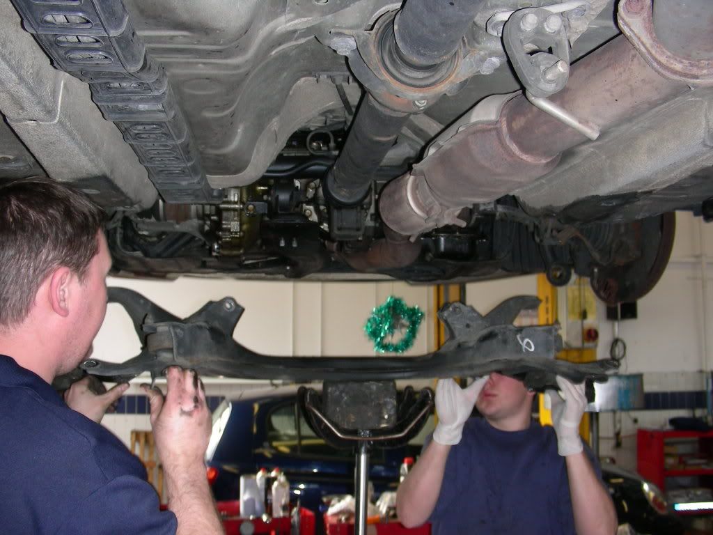

Round 2 !! was in the end not quite the battle expected primarily by pulling a flanker on all Mr Ts efforts to keep all joints held together by... (Peters idea) removing the subframe assembly complete with all the suspension attached. Worked a treat.. not to be recomended as a roadside job tho.

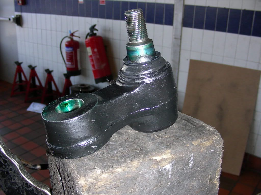

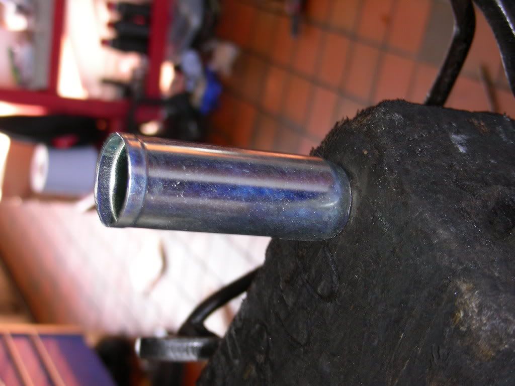

Once exposed necessary parts are much eaiser to remove and the replacements fitted to the subframe, with the crushtubes just dropping in as per factory fit for the banana arm replacement.
I have taken an idots guide photos and will get them posted here via a more compentent member after I e-mail.
Anyways from watching.... the experience I have learned apart from the necessity to have all the right tools, pullers, splitters, etc. is that anyone comtemplating fig 8 replacement (particually if it is the first known time) would be try to establish that the ball joints can actually be prized apart from their mounting plates prior to arranging for or completing the work. If this not possible have available servicable banana arms and replacement mounting plates to enable completion via Peters route of removal. This could save potential time off road in an MOT failure situation.
Cheers.. and a most happy Nigel C. :D

I know when DJ swapped my struts to TRD we had to drop the front hubs and original struts so they could be split on the bench
Perseverence and a gurtmungous 'ammer usually truimph if you can create enough room to swing
