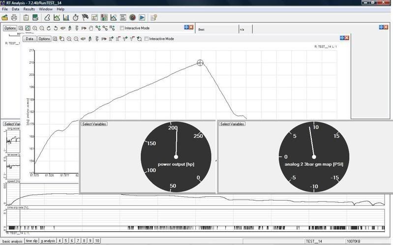

having installed the dl1 data logger configured all parameters , felt it rude not to do a few dyno runs, not bad for a 152k mile old ST205 with stainless system , cat ,oem air box with washable high flow filter , running 9 psi showed around 210hp @ road wheels.
My jap 185 running 9 psi , fmic , oem ecu , showed 187 hp using the same logger @ road wheels. :)
hopefully have knock sensor connected up shortly, see how noisy the ST205 is.
Black UK 96 205 shed with heater full on telemetry.
project six million dollar 185, faster, stronger, lighter than before.

Steve it's RT analysis latest version full of features, probably one of the best parts is sensor setup/calibration variable tables.
RT when used for power runs factors in gps ,wheel speed & rpm & two accelerometer's, making for an all round picture ot torque & power.
Having weighed the car, inputed gear rations, rolling circumference of rubber, etc etc should be good, the wrc wing under 50 does little, @ 140 does a lot this is picked up.

hooked dl1 to a few sensors, dl1 is isolated no issues with oem ecu sensors it seems.
a few externally mounted sensors.
charge cooler input from k probe via amp
oem air box sensor
hooked lines to to ecu,
rt sensor configuration custom variables to suit voltage over temp conversion for output readings.
have more sensors to install, making hardware fit into place is the timely part, somethings you just can stick a sensor in with making a sensor housing, its the water temps in the 4 quarters of the block is waht i am after.
coil hardwired twisted pair
gm 3 bar sensor for logging
not got far removing decat ,after a few studs snapped, now means manifold & turbo off job, being a real basket, the worry will be how many man to cylhead studs snap off , the studs and nuts very rusty ran out of time, will leave unitll i sort what turbo to use.
using oem o2 sensor output via custom variable ,makes for an interesting afr output reading, nothing more than an indication, long live the lm1, once manifold been dropped can use widband again.
my variable table for o2 lookup
any suggestion for better voltages for known afrs welcome.
volts afrs
0.1 17:1
0.2 16.5:1
0.3 16:1
0.4 15.4:1
0.5 14.9:1
0.6 14.4:1
0.7 13.8:1
0.8 13.2:1
0.9 12.7:1
0.985 12.1:1
you can over lay gps map over gps log data, all in all the dl1 is a very stable unit, just a shame it don’t have 50 inputs.
