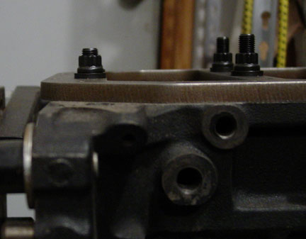

yes long thicker studs is a must, using the upper deck of the cylinder barrel is not a good idea..

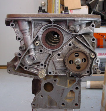

Loads induced from 4 wheel drive transmission system will certainly cause problems, running heavily tuned engines, that requiring much greater stability, small amounts of distortion will most defiantly cause catastrophic end results, but i don't think its the total contributor to the sort of problems that have been occurring, the cracking of the cylinder bores points one direction, the failure of the engine block is another.
The standard 3sgte block was designed to run road power, the mere nature of the block design, the thickness of material used, after all its lightweight cast iron , all points one way, Its against serious power hungry modders..

more important is how the block is reinforced, the 185 - 205 block does not have the webbing required to be reliable. fullstop
furthermore the engine mount bracket DO no share loads across, a typical area of improvement.

For comparison purposes this is the set up on my Elise engine
Supercharged VHPD engine
Numerous engine parts are machined, strengthened or replaced. These include a new set of strengthened Turbo Technics pistons, new forged connecting rods, a cast aluminium ladder frame to increase crankcase rigidity and high tensile through bolts. I believe it is possible to convert the Ford Cossie YB block to 'through bolt' configuration?
