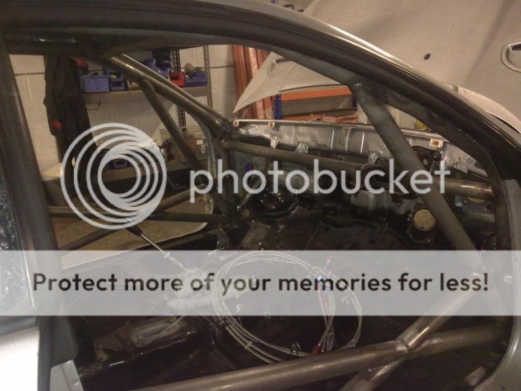

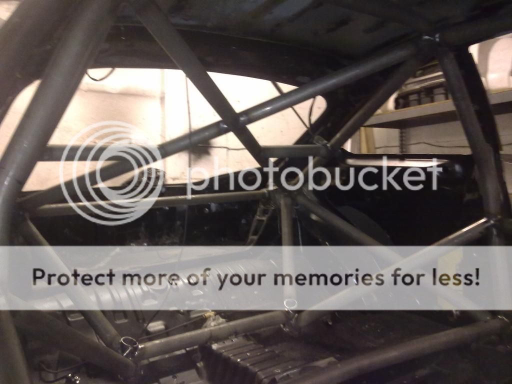

The Cage. CDS2 and complies with current MSA regs

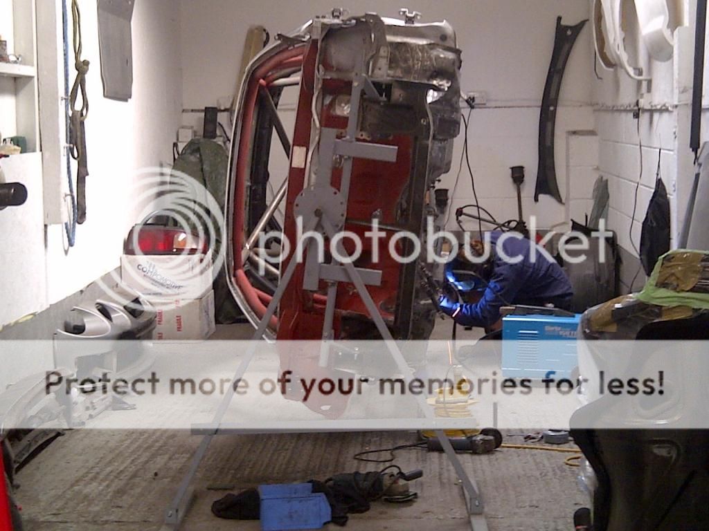

My mate seam welding

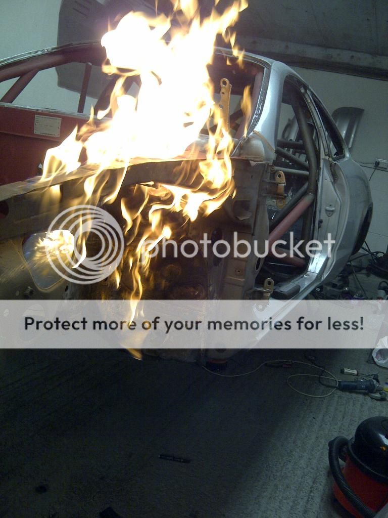

This is a bit extreme for removing the underseal. :lol:
