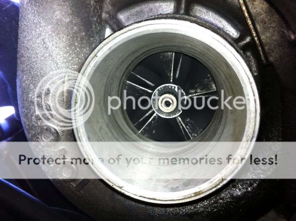

I had a bit of a hickup on the way to the show though as my turbo decided it didn't want to play anymore and ive blown the oil seal.
Currently on the hunt for a new turbo but should have one soon enough but im thinking if it is a good idea to change the down pipe and exhaust at the same time.
Thinking of going for a Japspeed 3" exhausts system with a 2.5" down pipe (trying to avoid the boost creep issues than can arise). Any thoughts on this? Also is it better to remove the turbo with the cat attached or is it easier to remove the turbo seperate from the cat, i figure if i am tacking and changing both of them them may come out easier as one?

hi mate car looking good :) when i take my turbo ff i split it from the down pipe and then of the manifold found that the be the easyest way to do it :)

Regarding your turbo and exhaust. Is the turbo standard or a hybrid? If you are having it rebuilt it would make a lot of sense to go for a hybrid spec OR if you are replacing it then you could go for something like the Turbo Technics S148 turbo which uses a bespoke turbine and doesn't suffer boost creep. They used to do a single wastegate version but I'm not sure if they are still available as the recent ones seem to be mainly twin wastegate designs.
Not all turbos suffer boost creep, in addition to the TT S148 there is Owen Developments hybrids which I ran for a number of years with no problem. I used a Hayward & Scott 3" downpipe and front section mated to a Blitz NUR Spect Type R 75mm centre and back section. Personally I'm not a fan of artificially restricting the exhaust gas flow at the downpipe. Its a bit like buying a Ferrari and not taking it out of first gear!
I'm currently running a Turbo Dynamics CT26 hybrid turbo on a standard ST205 without any problems but then you'd expect that as the cat is still fitted and the exhaust system is all OEM.

It's probably easier to get the turbo and cat out separately but as one job, the cat gone will make access to some of the bolts on the turbo easier.
I'd try to find a S148 single waste gate as mentioned above as an ideal solution otherwise you pay's your money and takes your choice.

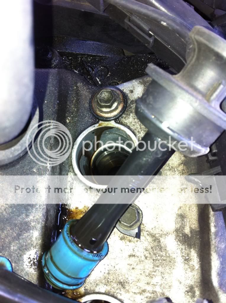

changed the rocker cover
it really needed it

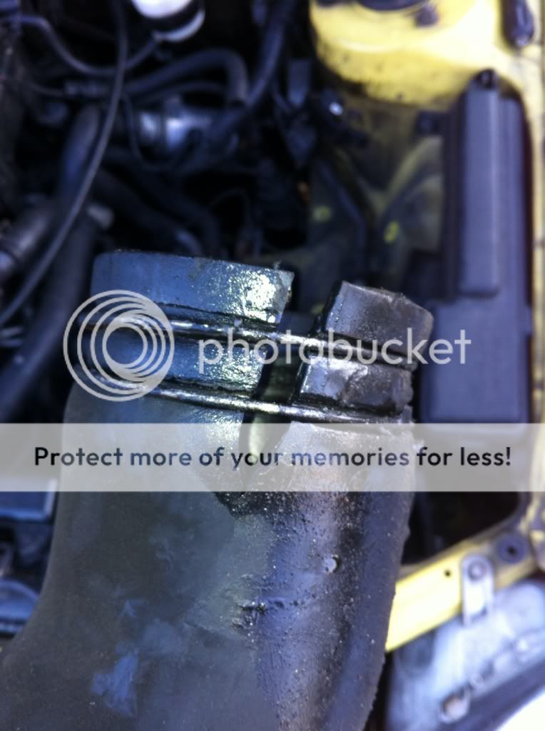

charcoal cat
blitz filter
duff turbo
probaly caused by this
