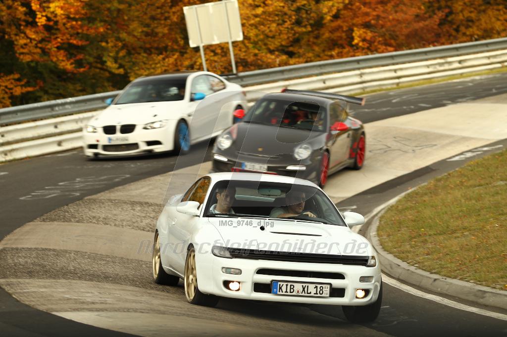

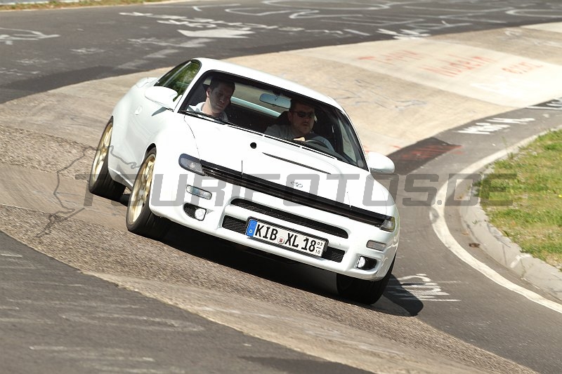

25 mm per side on the front and 40mm per side on the rear will be to much with +48 mm offset wheels.
On this picture I had 15 mm per side on the front and 40 mm per side on the back with 7,5x18 +48 mm offset wheels and 225/35-18 tires:
Not too hellaflush, but even therefore the wheel arcs in front and back had to be bend for tire clearence.
At harsh use on track the rear tires still rubbed the paint off the wheel arcs:
so I´ve changed to 30 mm spacers on the rear after that day on the Nürburgring. Now the rear wheels don´t damage the paint anymore:

XLarge,
its difficult to give exact advise as jgtcracer hasn't given the wheel diameter : 16" / 17" /18" /19 " ? , wheel width 6.5J, 7J, 7.5J, 8J etc or wheel offset !
do we assume it is to fit his ST185 or ST205 etc ?
is his car stock lowered on coilovers , springs or higher...

Just wanted to give a sample as I tought the same. But my choice of wheels and spacers should be a good sample for the ST185 as my wheels and tires are not too wide so different diameters won´t play a big role.
